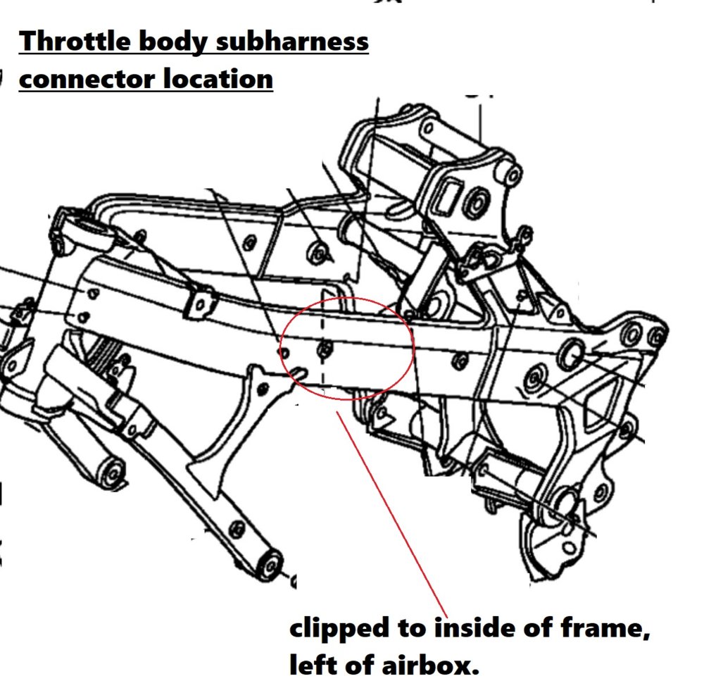

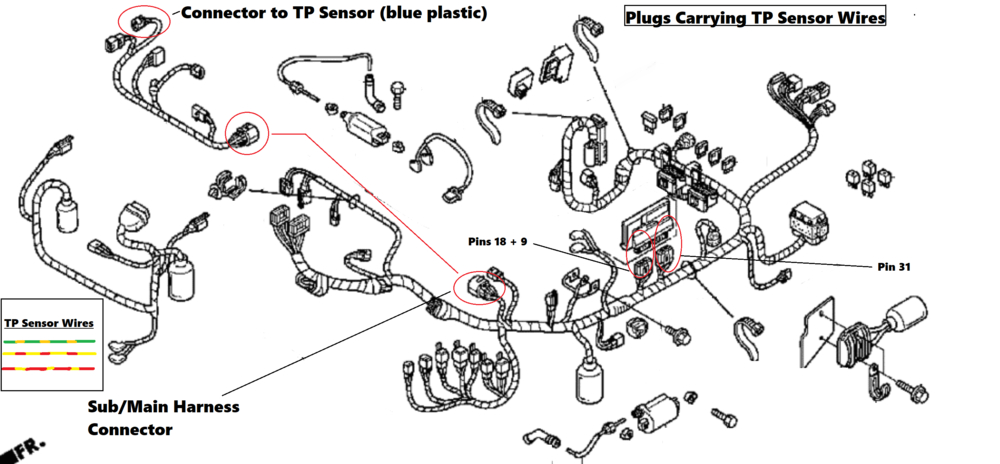

The throttle body sensors are plugged up with a subharness. What I was referring to as the "mid-connector" is the connector that joins the subharness to the bike's main harness. It's a gray plug that is clipped to the inside of the frame tube on a little metal stud. Pull the side panels, and lift the tank. Look in the little space between the left of the airbox and the inside of the frame rail, you'll see it. I should post these here too:
View attachment 18319View attachment 18320
Just seeing this , thanks for posting such a thorough illustration. Even though the problem is tentatively solved. It looks as this sub harness can be readily accessed and cleaned as a preventative measure.

My post here has images detailing the connector positions to clean. (#140)
That Mid Connecter was the likely cause of my MAP Sensor Code 1 intermittent failure years ago... I suspect. I don't think it was fully clicked together. IIRC none of the troubleshooting procedures ever check the connector for sensor failures... just checks the sensor or the ECM and overlooks the Mid Connector. The TPS, MAP, CMP and Fuel Injectors go thru that connector.

Too be clear for anyone reading "mid-connector" = 'throttle body subharness connector". It's the connection that joins the throttle body wiring harness with the bike's main harness.
