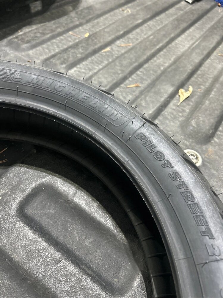

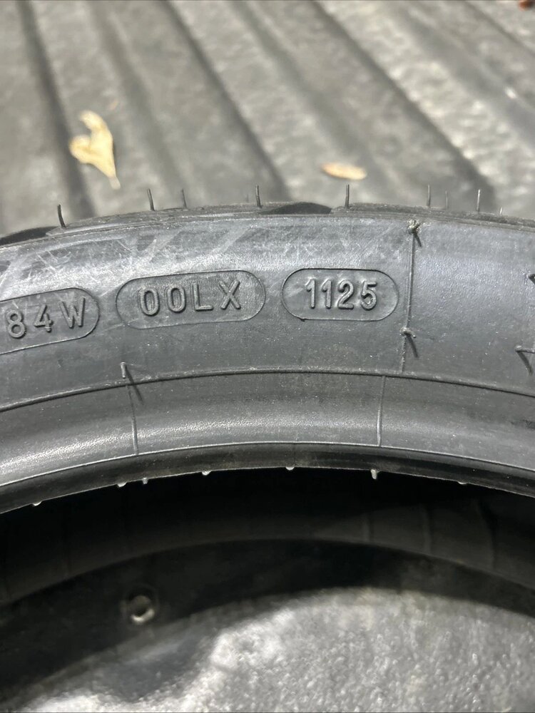

The StreetPilot 2 I'm looking at has an 84W rating.
Vendor I looked at and Michelin's own site for Pilot Street 2 list the 140 rear at 66S. Sure you aren't looking at something else?
I also checked with Michelin and they do rate it at 66S. The tire with that stamp is listed as Steet Pilot 2. I will look at it closer. The more I look, the more I am inclined to stay with stock size Conti-Motion.
Here's another pic on that tire, showing it as Street Pilot 2. In the details of the product, he has load rating of 66.
I'm not sure what's going on, but there's no way a Pilot Street 2 is rated at 84. That's an incredibly high load rating.
Maybe partial photo cutoff stamp of internal part #?
