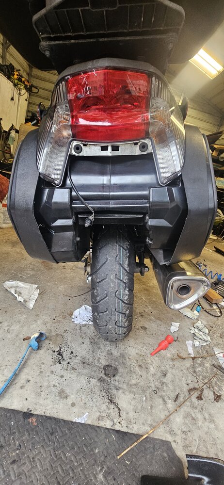

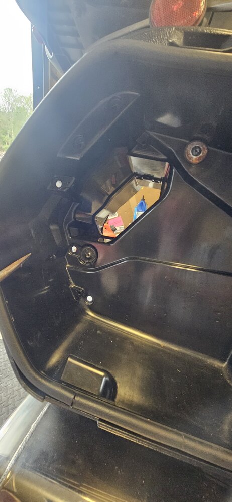

The rear fender must come off. There are three screws inside of the pannier each side that need to be removed. See pic . Be gentle as there are tabs and my 2010 let me know how brittle the plastic is after 16 years.

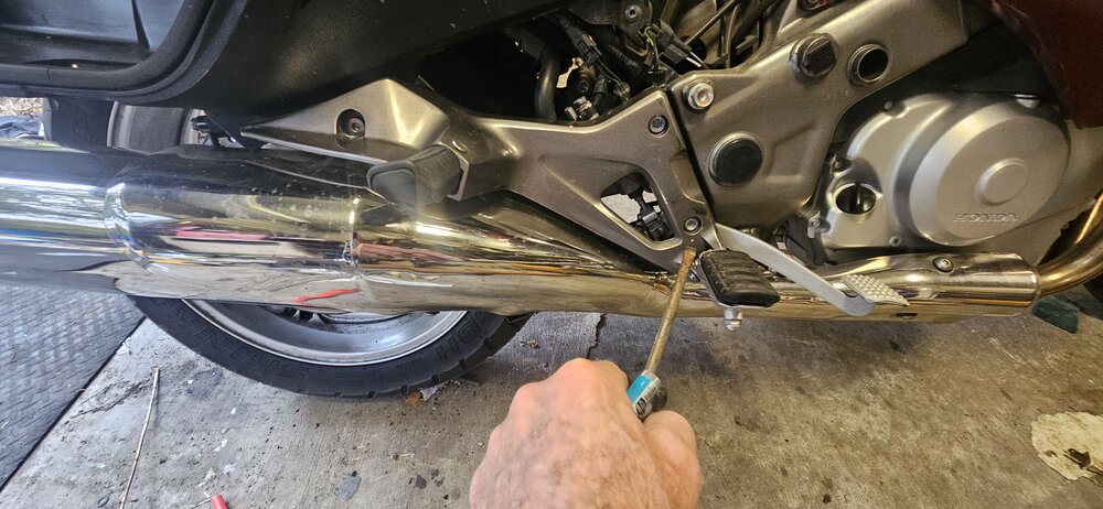

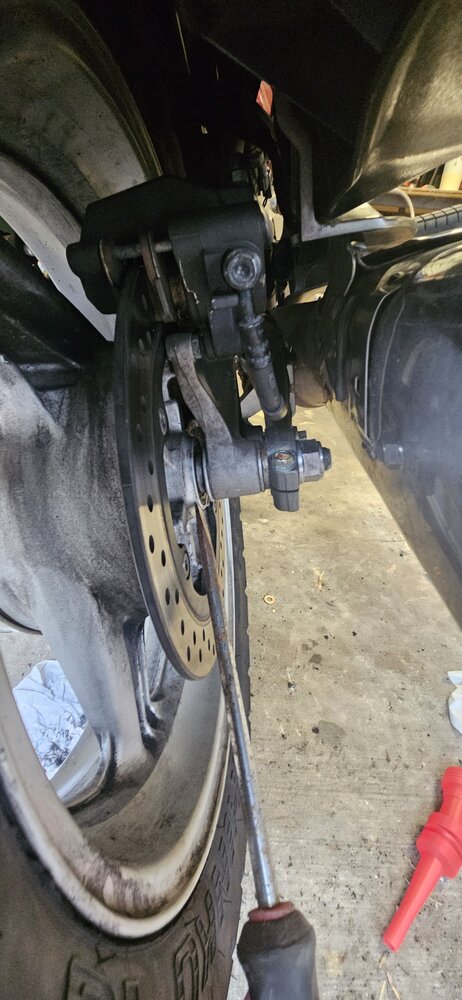

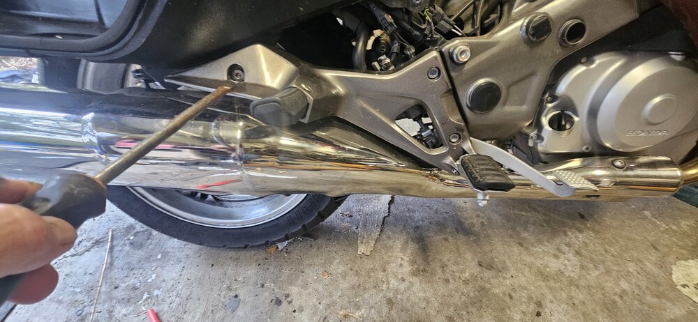

The exhaust does NOT need to be removed, however, you will want to loosen the two mounting screws for better access and remove the caliper bolt. see pic

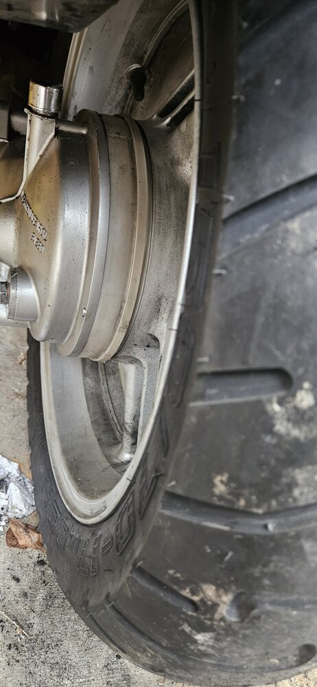

The bushing going into the wheel sits about 5mm proud. Did'nt seem right. see pic
The drive housing and it's mate do not seat completely together see pic

Used the torque wrench from the non exhaust side to avoid needing to remove exhaust.

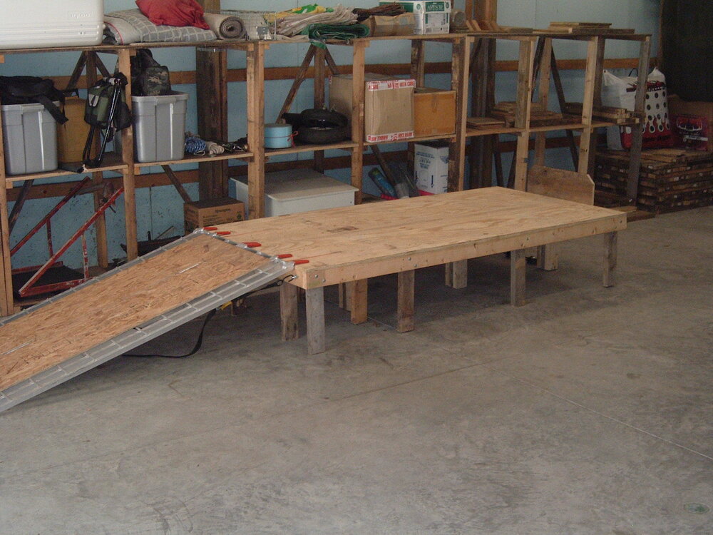

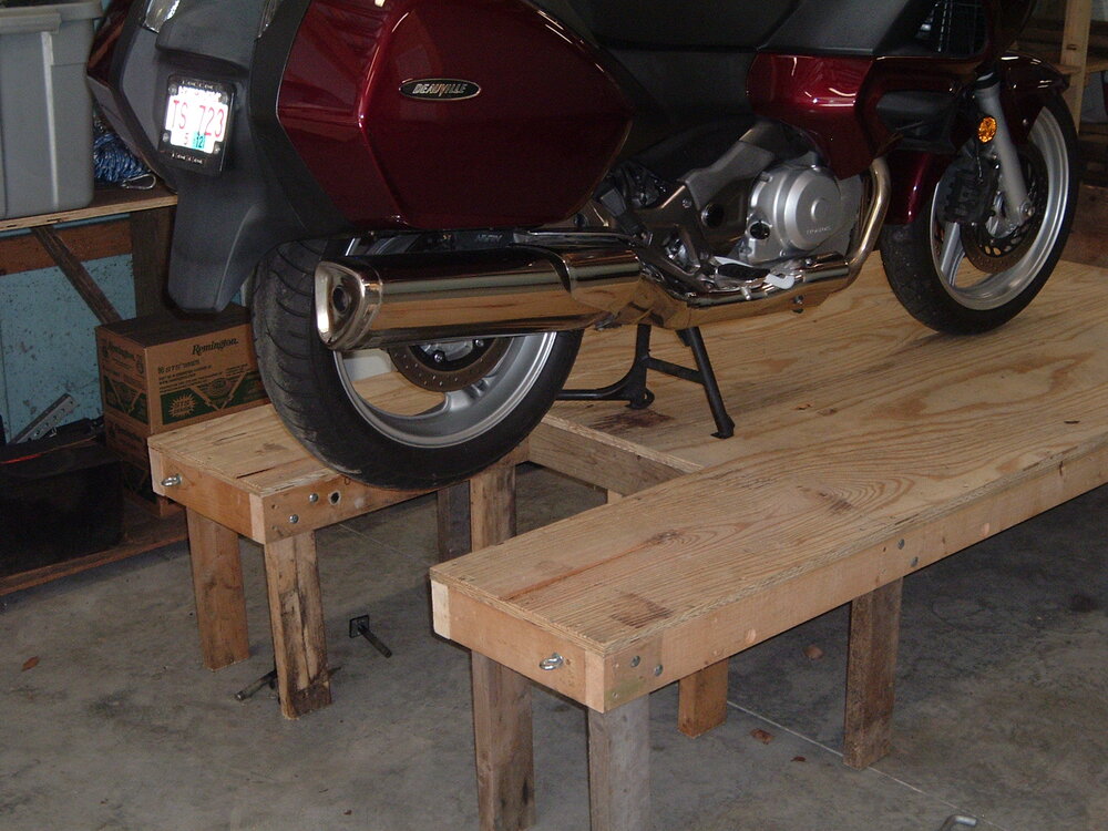

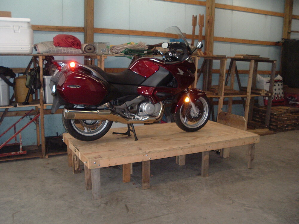

I ended up building a work stand for the NT. It has a drop out section under the rear tire. With that drop out removed the wheel & tire can drop down and be removed without loosening the exhaust or removing the fender.
I am lucky that I have the extra room for the work stand. It made it nicer esp. on rear tire changes.

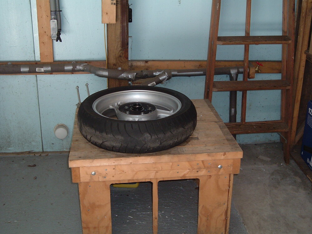

I also made a tire changing stand with a cutout for the brake disk to drop down into and a bracket with a long bar for breaking the bead. It made it more convenient to change them myself rather than taking the wheel to a shop.
Just showing options, enjoy the NT.

Not sure about your commets about final drive oil. There is a drain plug, a big fill cap and a vent on top. Be careful with torque I think under maintenance we have lots of tips and hints like ARKNT gave. I made a very simple version of ARKNT's system and yes, dont take off the exhaust, just loosen it. Dont forget that splines need lube.

I meant to say I torqued the axle bolt from the drive side due to poor access behind the exhaust
