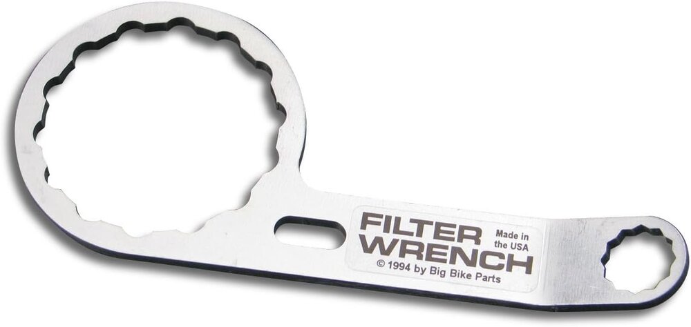

This is my tried and true oil filer wrench for both of my bikes. Show Chrome Accessories 4-201 Oil Filter Wrench. Currently $13 on Amazon. I find it is perfect for my needs. 515-x4CpfdL._AC_SL1200_.jpg
And it fits the genuine Honda filters? It's a good looking wrench!
I also have one of those filter wrenches. It grips the filter well.
It appears that the slipping on/off is much faster than with the Honda Cap Wrench so I'll give it a try. ;)
This is my tried and true oil filer wrench for both of my bikes. Show Chrome Accessories 4-201 Oil Filter Wrench. Currently $13 on Amazon. I find it is perfect for my needs. View attachment 20877
Yo Fieroguy - just to make sure before I make a purchase, are you using this wrench on an NT filter, or some other bike?
Of course it will work for filters on other bikes, I just want to be sure it works on the filter on my NT.
Thanks in advance for the clarification,
Rick
I used that wrench on my NT. They weren't Honda filters, aftermarket.
If I remember correctly (questionable) I bought mine at local Honda dealer.
Dunno, the Honda cap wrenches sit quite tight, need to clean the road grime off the old filter before getting it on, some wiggle & pry to get it off before unscrewing the filter from the base...
Avoiding aftermarket I can't tell compatibility to HighFlow and others though...
I use Hiflow oil filters and my old Honda cap wrench works great on those filters. No issues ever.
I have only used Honda oil filters and the filter wrench I use is a perfect fit. I can't speak for the wrench fitting any aftermarket filters.
Larry - Yesterday, I used my 4-201 oil filter wrench for the first time and it worked GREAT! I was changing oil & filter on my CB500F and it only took a few seconds to attach the wrench and get the filter moving and the same with installing the new filter.
Thanks for the heads-up! :thumb:
