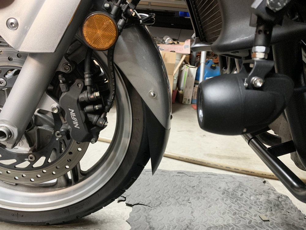

Both the LED Driving Lights and the tubing mounting brackets came in the last couple of days.
At first, I was not too impressed with the tubing mounting kit that I selected as it did not give me a straightforward solution. The mounting kit came with two different mount piece sizes for a wide range of options. Unfortunately, nothing of them would work very easily with the light configuration that I choose.
After spending some time staring at everything for a while. Here's my solution to my dilemma.
1. Drill and tap of the shorter mount pieces to convert it into a mounting interface.
2. Then screw in the mounting bolt from the light assembly mount bracket and then bolt the piece to the installed mounting clamp.
3. The interfacing piece not gets me pivot point to aid with aiming the light.
4. With very thing assembled loosely, looks like that this concept will be a solid solution to the dilemma.
I trip to the hardware store tomorrow will take care of the fine details and will help to solidify this solution into something more permanent. Then I can move on to wiring them up.

Good news, I was able to get the Tupperware off of NaTalie and wiring up the new lights this evening.
I then was able did some alignment testing using my garage door as a target.
These images do not really show the correct color of these lights. The new light look yellow, in fact they are not.

Bruce, it's hard to tell how your lights are aligned from your pictures. My procedure has been to align the sharp cutoff on the low beam at a height equal to the height of low beam bulb on the bike when my weight is on the bike. This assumes that your driveway is flat (not necessarily horizantal) from where the bike is to the door. When aligned that way the low beam cutoff hits most sedans just below the bottom of the rear window and the front window if they're coming toward you.

I really need to take the bike to large empty parking lot after dark to do the alignment properly. This method usually works and gets me 80% there.
