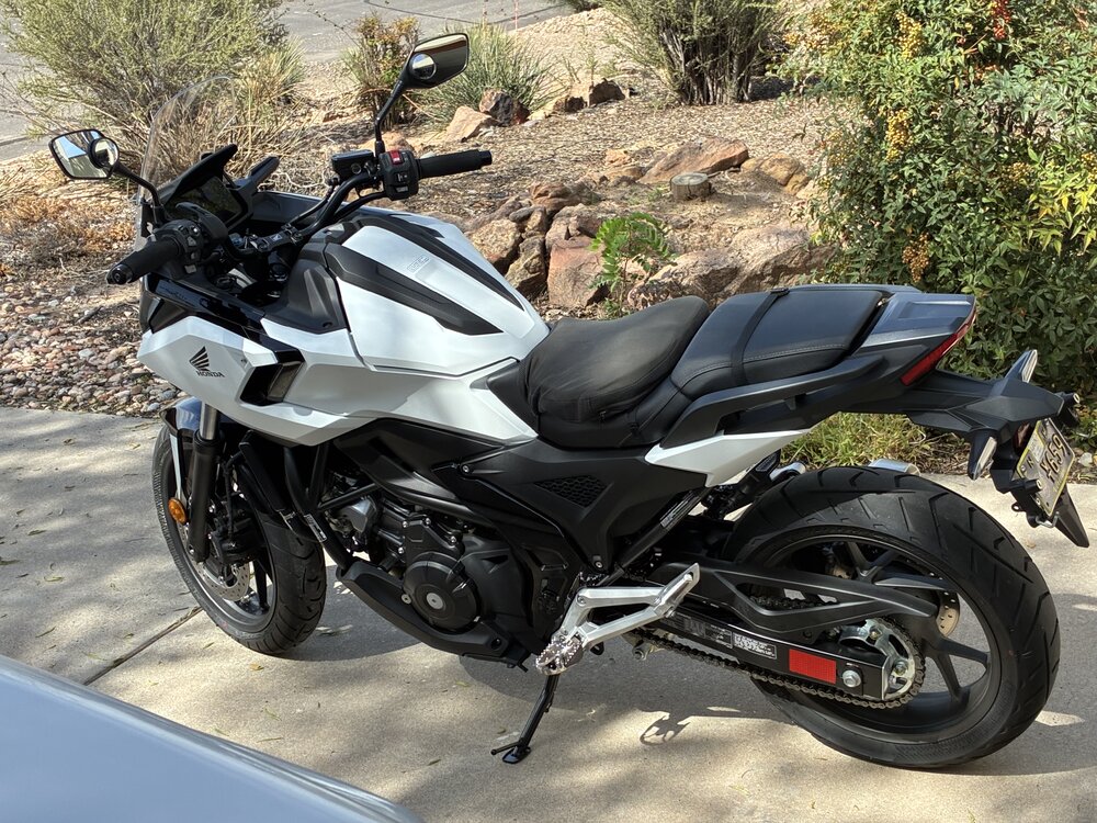

Ok, ok. Point made. I ordered a center stand from Partzilla. Along with the Honda “ComfortSeat”. Unfortunately, both on back order.
Honda’s center stand is HALF the price of SW-Motech.

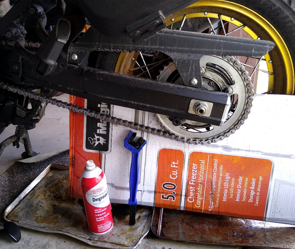

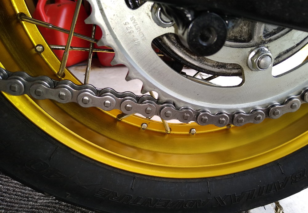

My personal opinion is that I don’t apply the DuPont wax based chain lube unless the chain is CLEAN and dry.
I use a pressure washer (car wash) when traveling. I just don’t get real close to the chain when cleaning to avoid blowing out the o’ring seals.
I hate to imbed dust and dirt in the lube.
You are correct about letting the cleaner evaporate. On tours, I have been known to use the wax as a cleaner first if I have to ride through a destruction zone. Chains are a PITA when someone decided to take away the protective enclosed case.
