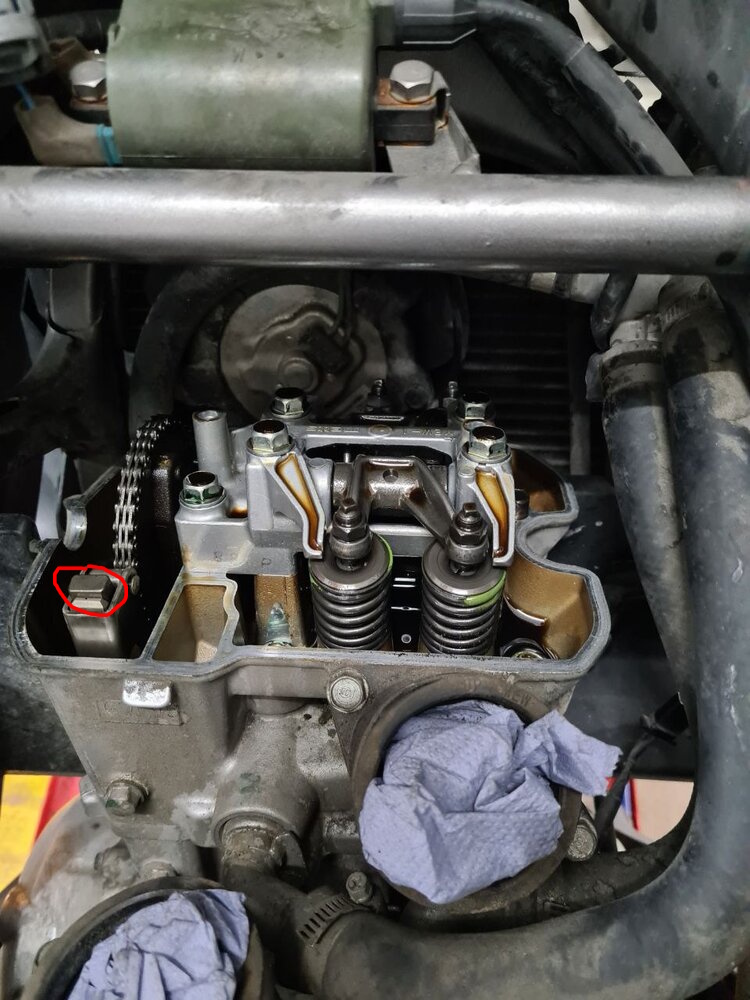

as ze GF is riding the wheels off that thing, we quickly approach the 100,000km mark on that '07 NT700VA...
And during the last valve clearance check, I saw the wear indicators on the tensioners are raising towards the [replace] mark...
No noises yet, but I like to be prepared...
Will consult the w/shop manual on the w/e to see if I'll have to knock the engine out and apart for this (thus need a full gasket kit), or if its an "in the frame" treatment...
Gonna be a winter project...
Anyone been there yet? Any hints, dos and don'ts?

Well, I observed them raising for +1mm over the years/miles (~1mm @ 36,000km when we got the NT, to >2mm @ 90,000km now... IIRC are 2.4mm protruding the wear limit indication...)
So I'll keep an eye on that...
