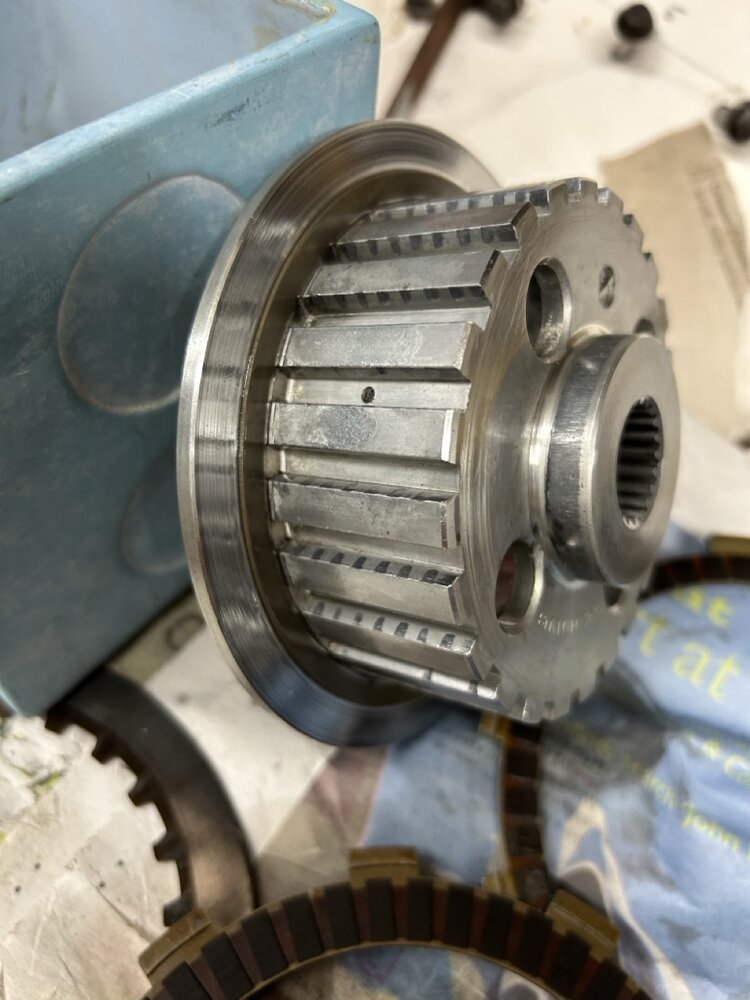

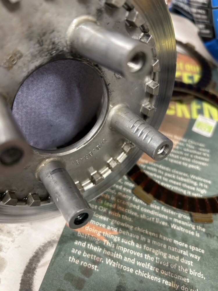

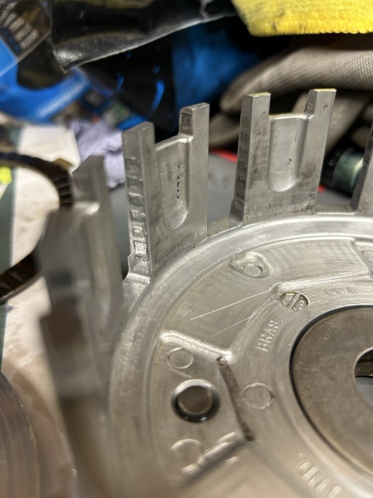

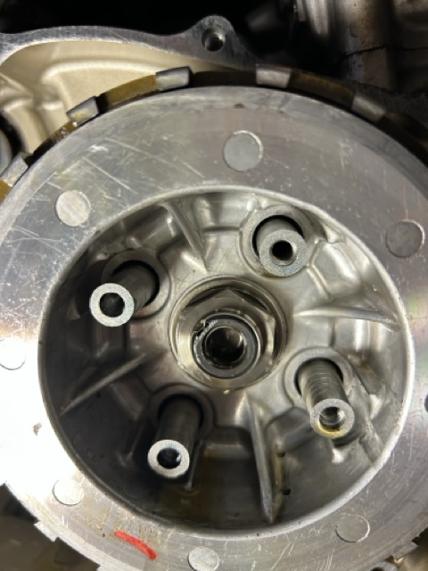

Hello following on from my recent thread regarding difficulty engaging neutral on my 2007 NT700VA , I decided to take the plunge and open the clutch up. I found three areas where there are burrs on the clutch components which may be causing clutch drag. The spring posts, the inner basket grooves in which the inner fingers of the steel plates run and the outer basket where the outer fingers of the friction plates run. I have attached some photos. At first I thought I might replace these but having seen the cost (approx £750) I am instead going to see if I can dress the burrs and will then rebuild the clutch and hopefully that may improve matters enough. Perhaps new springs may be worth installing as they aren’t too expensive.
For information to remove the clutch side engine cover I did the following - removed clutch cable, exhaust silencer (not downpipes), plastic cover over right engine guard so I could eyeball one of the clutch cover screws without having to remove side fairing and all that entails. The only difficulty I had was removing the clutch nut. The front of the clutch nut has an integral ring which is used to lock the nut into a slot on the shaft. Trying to punch the indented section up out of the slot unfortunately resulted in me basically flattening that part of the ring in the slot. I eventually resolved this by drilling a 4mm hole in the nut close to the slot to weaken the bent part of the ring enough before proceeding to attempt nut removal. The 27mm clutch nut was incredibly tight (normal right hand thread) but I managed to shift it though a combination of an air operated impact driver and a 600mm breaker bar.

Thank you Coyote Chris. I am currently dressing burrs on the components in photos. The clutch friction and steel plates all appear fine. The 4 springs are well within service limits too but I have ordered 4 new ones thinking that may help overcome any sticking on any residual roughness. A new clutch nut is going to take about a week or so to come.
Regarding wondering what happened to make this occur ?. Perhaps at sometime when the bike was stationary on its centre stand and someone got on it and pushed it off the stand without realising the bike was in first gear causing the clutch plates to suddenly be smashed against the basket. I am just guessing and probably talking rubbish. Thanks for your interest.

I'll not be much help on correct plates for your bike but from the wear notches on the clutch basket my guess is some oil issues somewhere in its past. Maybe improper oil or wrong viscosity.
You may be able to clean it up satisfactory but be patient with it. it could take a while to clean up well.

Thanks. I think I’ve made a reasonable job of cleaning up the burrs since posting the photos . I’m just trying to figure out way forward regarding the friction plate discrepancy

Interestingly a couple of years ago, I helped a friend out on his Mutt 125 motorcycle with a similar issue (difficulty selecting neutral and crashing into gear). On inspection of his clutch basket it too had burrs on the inner and outer components preventing the steel plates and friction plates moving smoothly. Luckily for him, we were able to buy a completely new clutch for approximately £70 which completely resolved the issue. Unfortunately the cost of a complete replacement of my Deauville clutch would be half the price of what my bike is probably worth.
