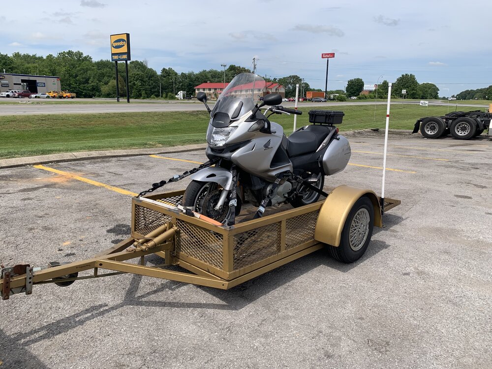

I put soft ties through the lower triple tree fork clamp, and attached my ratchet straps to them. Braced front wheel. Ran ratchet strap through rear wheel pulling rearward and opposite the front straps. 120 miles, stopped early to check/ tighten straps.

I think you will find that between a wheel chock and the tip over wings you will have no trouble. I sometimes run two forward and diagonally plus two straightout to the side. have trailered mine many times like that with no issues
So it followed me home. Thanks to all for the feedback. I'm looking forward to getting acquainted with the motorcycle, and the rider's group. I'm not bashful about asking questions, but will try search first as to not create more digital junk on the server.
Best to all for a safe and enjoyable Memorial Day weekend, and keep the shiny side up!
Lower triple and crash bars, excellent choice...
