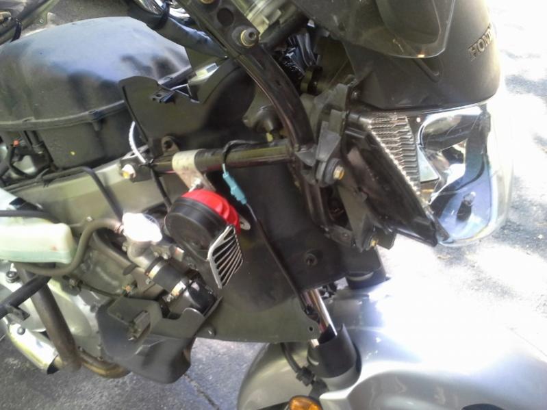

Mounting location wound up being in, for lack of a better term, the cheek pouches of the NT. I used aluminum stock sheet to form a bracket. forming was done by hand and with pliers. Bracket was installed over electrical tape to give the aluminum some extra grip on the frame. I used 1/4 inch bolts and lock washers to attach the bracket from the horn kit to each homemade mount.

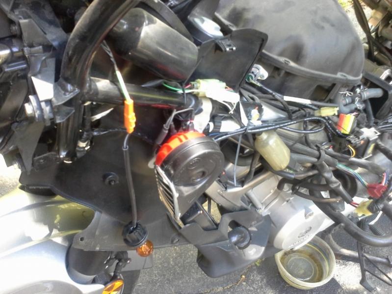

To get the horns in a good location in the fairing I drilled a hole in the middle of the stock brackets to get proper length so the horns do not hit the fairing panels. you can see the extra bit from the stock bracket sticking out behind the horn in this picture.

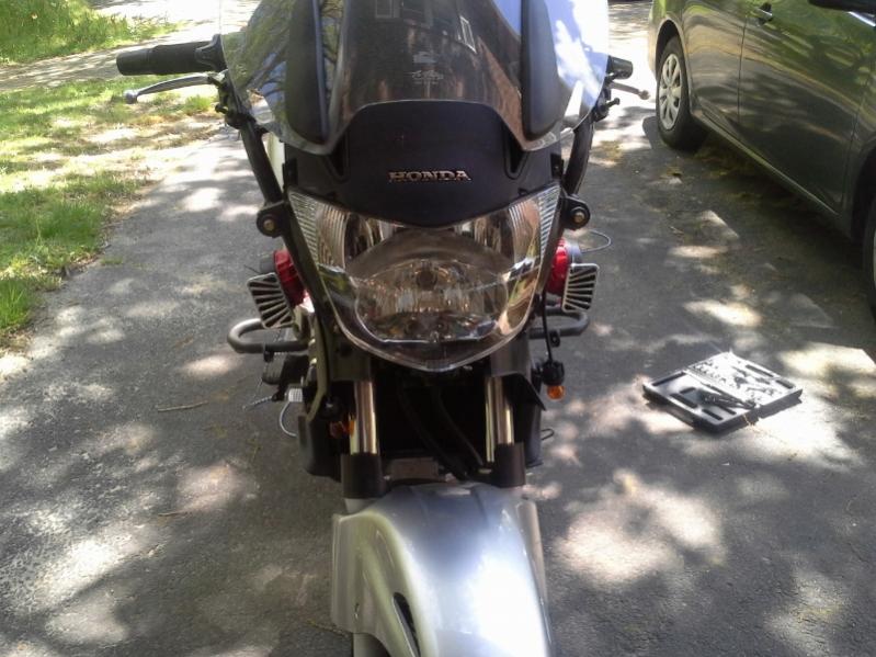

You can see the positioning of the horns from the front. One horn fit on each side. When I put the fairings back on I was able to make minor adjustments to keep the horns from rubbing the inside of the fairing by bending the horn brackets slightly. This tweaking did not require re-removal of the fairings.
