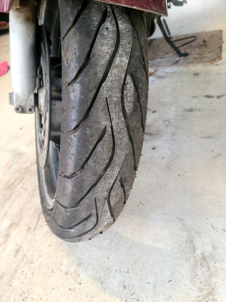

In the picture, your wear bars appear to be in the third tread up from the bottom, (EDIT: bottommost fully visible) They should be in all treads all the way across. The two I can see have a good lip on them.
EDIT: There should also be a triangle in the sidewall, with the apex pointed to the wear line.
Here's what it looks like brand new. I don't recall seeing any tread go all the way across. I will look for the triangle - thnks!

New tire with 1000 miles on it. Note wear bar.
