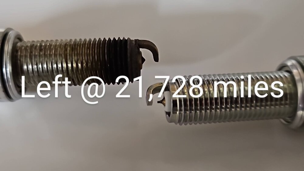

I don't like Iridium plugs... they work well but, many have notices the tips missing if they go beyond the 12,000 mile main interval (BMW R1250 engines)
Mine on the RT looked good at 12k so I left in, then got paranoid and checked again at 21k miles (left-old right-new) bike never ran bad and I think the tip burnt off, not fell off:

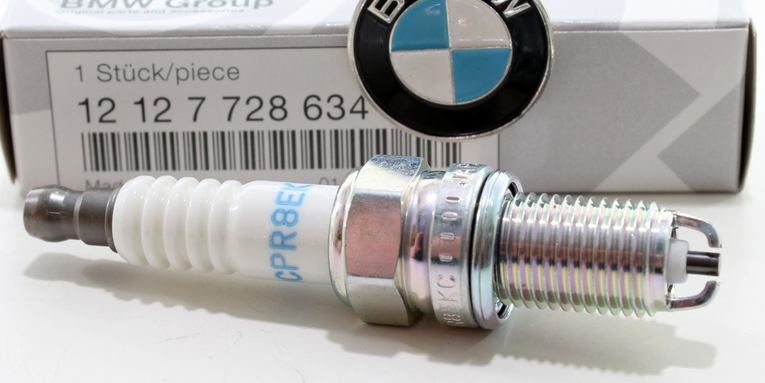

I replaced with Iridiums since I had them already but the next change I'll use the plugs the R1200 bikes used:
I think they'll last longer even though changing the plugs is easy on the boxer engine - I don't want the tips falling off.

Thanks for the info! A guy posted pics of his FJR iridiums after 35,000 and they looked fine but the Small tips do bother me. I like the R1200 plug design. The Suzuki iridiums are $25 apiece. Crazy. I think the fact that they still worked at 21k is more of a tribute to the strength of the spark of a modern ignition system.
