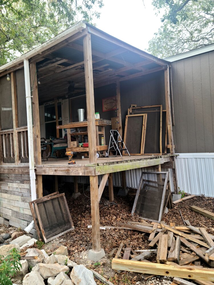

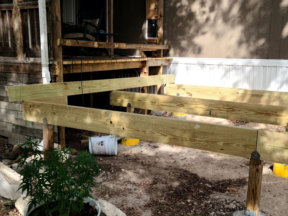

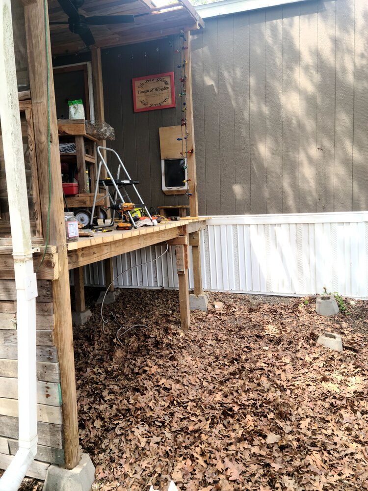

We bought a manufactured home (new term for newer mobile homes) when we moved to south Texas in 2020. We've decided it would be nice to have another living room or den for when we have people over. Rules on manufactured homes prohibit structurally connecting any other structure to the home. Porches and other additions must have their own foundation and roof systems; they can be connected by flexible, non-structural materials.
When we moved here, I built a large covered porch then screened it in. I cut 5 feet off that to make room for the room. I have the pier and beam foundation completed and set the first joist in place. The new room will be 14 x 18 and have a pocket door that opens into the hallway of the house. The floor will be 3 short steps lower than the floor of the house.

I've done structural modifications to a home before and research local codes, etc. before I begin work. In this county, the only permits or inspections required are for a.) septic systems and b.) driveways that connect to a county road. We have few varmints here. I have read up on construction methods and load calculations. Total live weight of this room looks to be just under 13k pounds. The average load on the piers is less than 1.5k pounds. The middle piers carry more - each can bear up over 4k pounds. The frost line is 6 inches - the concrete piers are 12 inches diameter and 18 inches into the ground. Southern white pine for beams, joists, and rafters.

I spent most of today installing joists and putting cover boards on the face of them. Almost done with joists.
The middle beam sticks out about 2 feet further than the outer beams to provide the spine for a small platform to hold the outside part of the mini-split AC/Heater.
