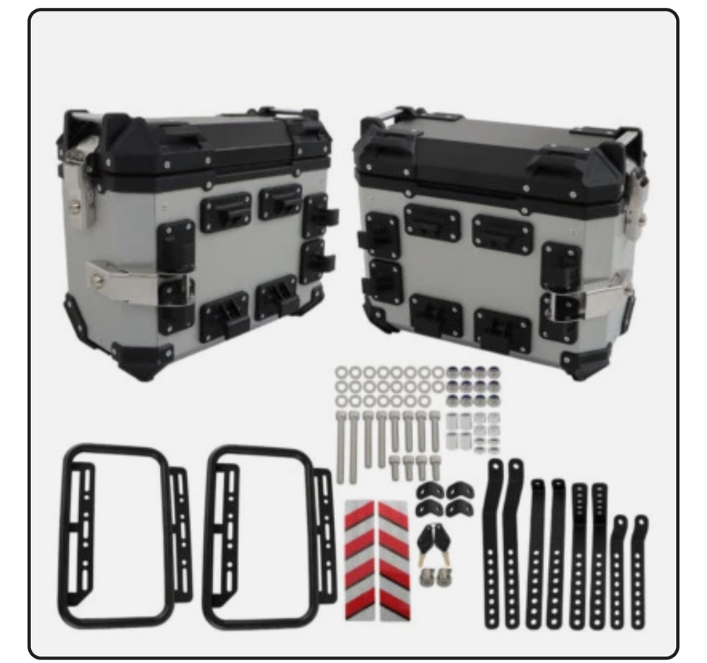

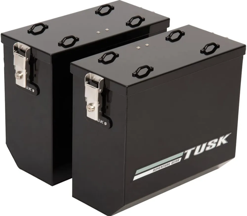

I've been shopping a lot of saddlebags recently for a ride that doesn't have Givi or Shad specific mounts.
FYI there are "universal" options out there so you don't have to try and find some Givi rack for another bike to hack apart or adapt.
Tusk makes V2 aluminum panniers in two sizes. Offered in black and silver. These are flat back and you drill holes where you want them. They do offer a rack for them you'd mount to whatever. Rack isn't specifically needed if you don't need it. Just bolt the boxes up. These seem to be well regarded in the ADV/dual sport community
If you go on eBay and run a search for "motorcycle side cases". You'll find example of these all over. Come with a rack you again mount to whatever you have.
I thought about buying those, but didn't want big cases that stick out too far.
The bottom cases look like they have plastic attachment devices on the cases themselves. At this point in the game, I would be chary of plastic attachment brackets.
